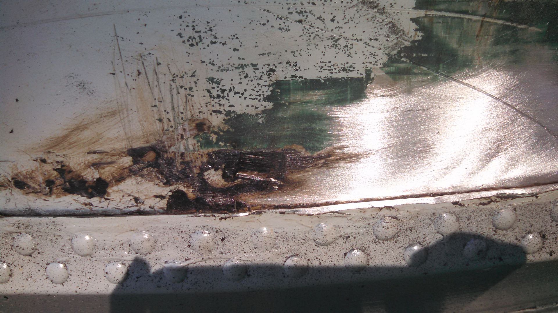

Whatever this stuff is, it's very unforgiving...kinda looks like roofing tar...?
I have decided that this IS roofing tar. Smells like it, feels like it...
Made some more progress today, I'm having to scrape the real thick parts away then using a soft wire brush on my drill I can remove the rest of it:

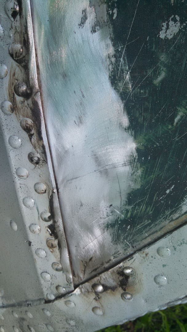

My plan here is to either use an Aluminum brazing rod to fill in this seam or maybe use some JB Weld to fill it in before I paint it.
Thanks. I will probably end up using the rods, that way (Hopefully) it will be permanent. Taking my time with this (As time allows) so I can actually get it done the way I want.
Don't use heat along the seam. There is usually a sealer that will burn out and cause more leaks.

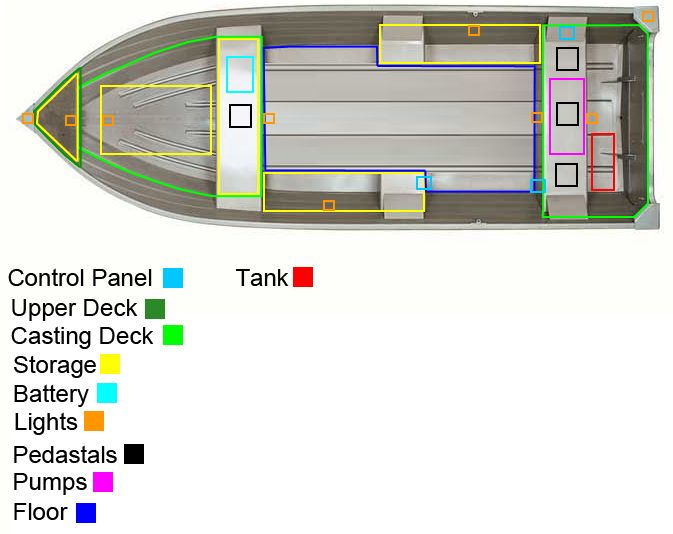

My plan for the boat (I stole ideas from others here, hope you don't mind):
What you don't see is flotation. There will be flotation under the floor, in and around all storage and in both benches. This plan may change as I go along with the build. The storage areas you see on the sides, I may run them from front to back.

Why not just go along those edges with 5200 or some flexible marine sealant? Run a bead right along that edge like the corners of a bathtub. It will flex with the boat and can be replaced easily if needed. Less mess.....
RStewart, I have your build bookmarked.
sonny.barile, I plan to use something on the inside of the boat like that to fill in the seam and cover the rivets. I was trying to use something on the outside more Durable I guess you could say, I figured the inside would see less friction because of water or debris than the outside.

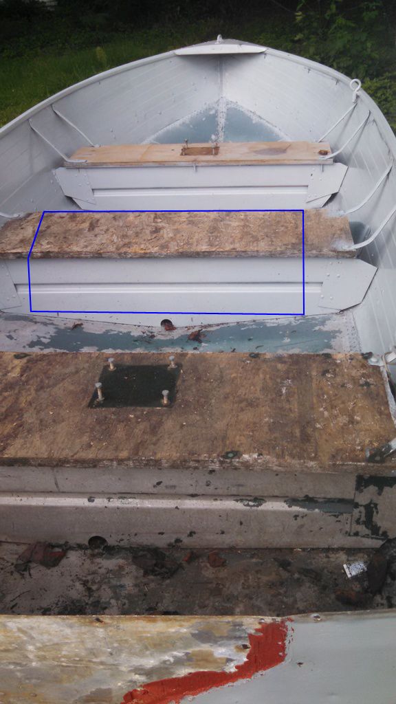

I'm planning on cutting the middle bench down each side and across the top of the drain hole.
Hopefully this will help to keep the some of the side strength plus add some bracing for the floor.
No...actual size is 14' 6 3/8". I'm guessing they didn't want to add all those numbers on the registration so they just rounded up. I am thinking about trading a 4 wheeler I have here for a 14' flat bottom with a 20 hp johnson. Only saw pics of it so far. Looks like a pretty nice boat.
My middle bench was already out of mine & the way I ran the 2x4s to support the floor it also adds strength to the boat front to back & using the factory side supports on the front & back benches supports the sides plenty.
