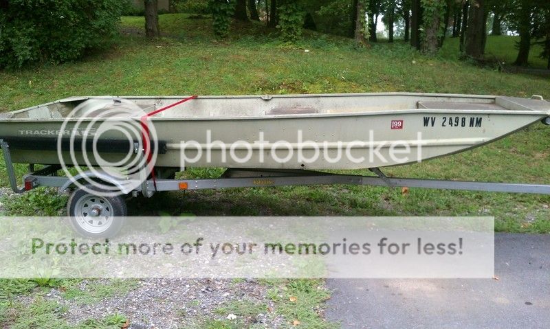

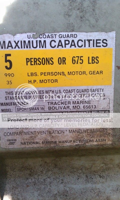

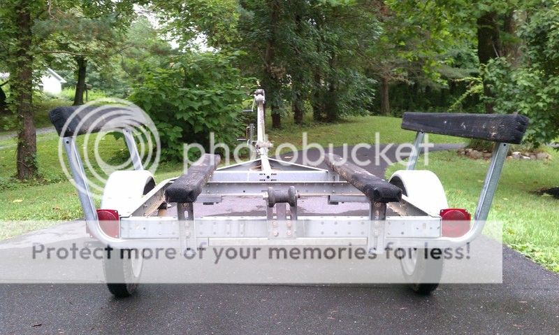

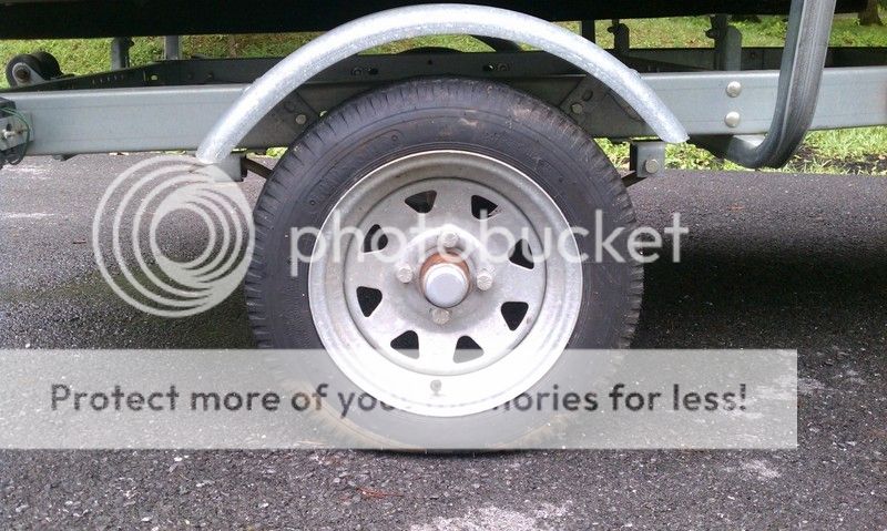

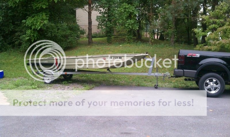

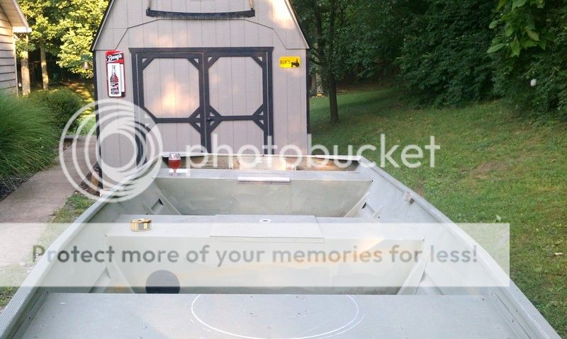

Tracker Sportsman 16'

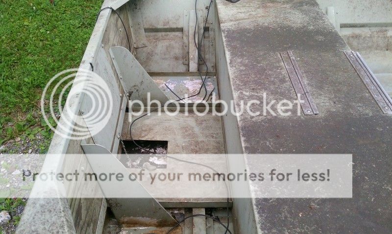

The day I brought her home:
![Image]()
![Image]()
![Image]()
![Image]()

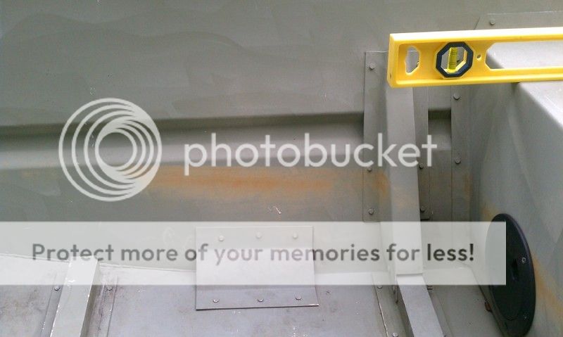

Was told this issue can be fixed by adjusting the bow roller down since it looks like the boat is sitting a little stern heavy on the trailer. Theres also a stern roller on the trailer, but the boat sits to far forward to touch it. Should I also adjust the bow roller back to get use out of the stern roller?

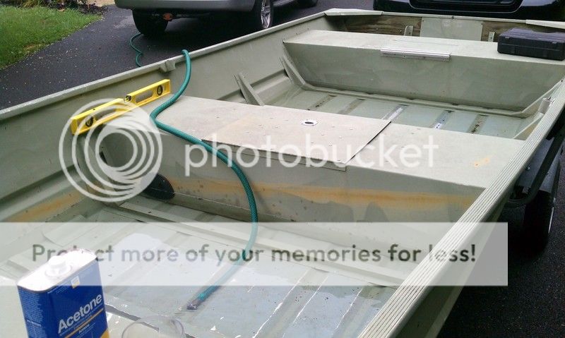

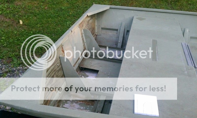

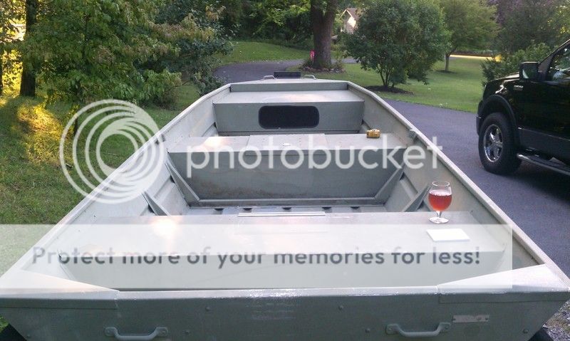

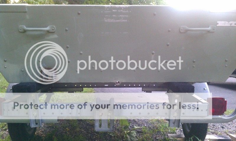

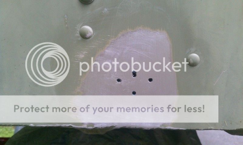

What do you guys think about the transom? It seems to be in decent shape, but is obviously the original and is about 17 years old. Seems like it would be fairly easy to replace without having to remove any rivets. I'd rather do this now if it's only going to last a few more years.
![Image]()
![Image]()

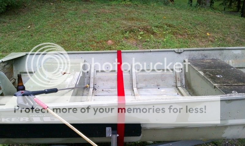

Halfway through a pressure washing. Didn't get any after pictures since it started to rain. But she really cleaned up surprisingly well.

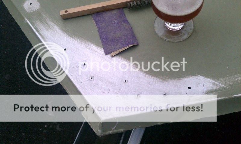

A few pics to show how well she cleaned up. Just a thorough pressure washing did wonders!!
![Image]()
![Image]()
![Image]()
![Image]()

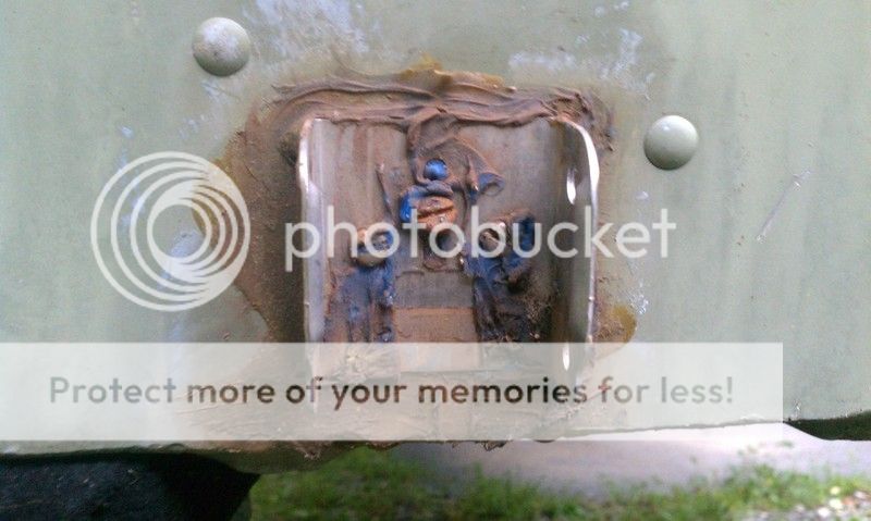

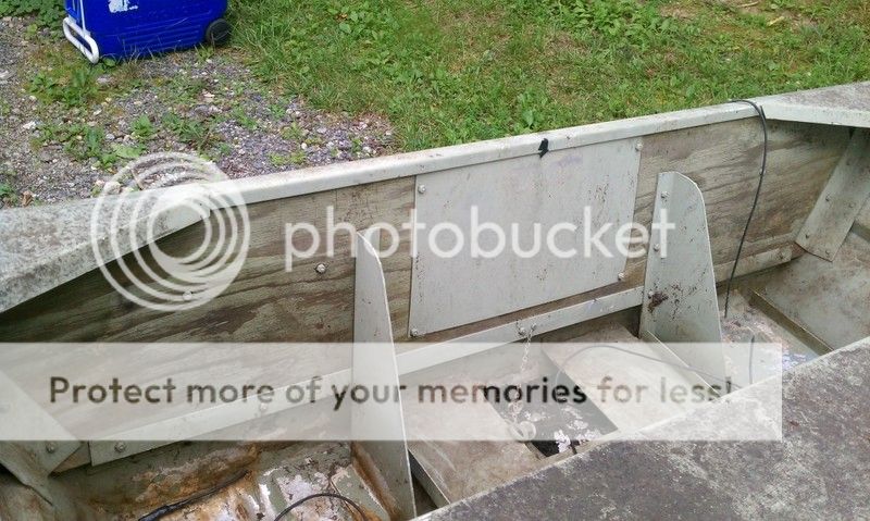

Here is a pic of the stern trailer roller I was mentioning thats not doing a thing. I need to adjust the bow roller down and back so I can get the stern of the boat over this roller. The more I looked over things I realized the bottom and side bunks are somewhat out of whack and need adjusting so the boat is sitting centered on the trailer and not resting on the ribs. You can see how off center she sits on trailer, and to get her centered the bottom bunks would be resting on the ribs, which I don't think is the best way to go. Where should the bottom bunks be resting? More towards the center or outer part of the boat?
![Image]()
Still not sure what I should do with the few dents in the hull. Hammer 'em out, or leave them alone? Any suggestions? I'll try and get some pictures of the dents I'm reffering to.

Cleaned up real nice,good size,looks ready to go as is.
If those little pieces added to your boat(bow and stern) are steel...I'd get them off first.
I find a bow mount trolling motor easier to fish with but depends on your style fishing.
Looks like you already have a little bow deck,are you thinking raising it?
Are you planing to do all these mods right away,seems it might add up in a hurry.
Might off been cheaper to buy a loaded boat to start with but I guess you will get what you want this way.

Nice cleanup job
. I think You've 2 pcs. to remove though, the TM mount on the bow, and the FF transducer mount on the rear. The rear is showing corrosion now, so get it off asap, then clean good ,down to bare metal and put some self etching primer on to seal up the surface for now. As far as the dents go, IF THEY'RE NOT LEAKING, I'd leave them alone since they're out of sight, rather than maybe make a crack from pushing the aluminum back past center point of where it's already been strecthed. Look at them as river character, and move on to the part You really want to change. You've got a great start, carryon with it!!
MHO
If something was done unorthodox, I might have had a hand in it, and then again I might have had the ONLY hands in it!

I mentioned in my last post about the transducer and trolling motor mount. What looks like corrosion around the transducer is some sort of sealant the previous owner had used to seal up around the transducer. I'm still anxious to see what I'm going to be dealing with under the transducer once I remove it. Hopefullly it don't be to bad!!! Thanks for the advice on the dents. I really doubt they leak, but I'll find out this weekend when I do a leak test. I was really stumped on what to do. Never thought about causing a crack while trying to beat them out. Thanks!!! Should I sand down the corroded area around the screw holes from the TM mount and throw on some primer like you suggested for the transducer? Only place I've found any corrosion/rust so far. Hopefullly it stays that way.novaman wrote:Nice cleanup job. I think You've 2 pcs. to remove though, the TM mount on the bow, and the FF transducer mount on the rear. The rear is showing corrosion now, so get it off asap, then clean good ,down to bare metal and put some self etching primer on to seal up the surface for now. As far as the dents go, IF THEY'RE NOT LEAKING, I'd leave them alone since they're out of sight, rather than maybe make a crack from pushing the aluminum back past center point of where it's already been strecthed. Look at them as river character, and move on to the part You really want to change. You've got a great start, carryon with it!!
MHO

Here is s agood pic of what the metal (galvinized steel??) trolling motor bracket that the previous owner had installed on the bow did to the aluminum. Going to pick up some self etching primer this evening and take a wire brush to debur the old screw holes. Then I'll sand it down to bare meteal and throw on some of the primer.

Here is whats left of the transducer bracket. I'm going to do a thorough leak test before I remove this mess. I'm anxious to see what I'm going to find underneath
![Image]()

Got a little bit of work done yesterday. Once it finally stopped raining I was able to clean up the corroded areas around the old TM bracket and stern transducer. Did a good leak test and only found 1 leak!! She's leaking from the drain plug. The aluminum opening was a bit smashed when I got the boat. I simply rounded it back out with a screwdriver so the plug would fit. Obviously the plug doesn't fit as well as it should, although it seems like I have to really smash it in to get it in the hole. Maybe the plug is bad?? Whats the best remedy for this?? Also pulled her off the trailer, gave the trailer a good pressure washing and got all the bunks and rollers adjusted. She sits alot better on the trailer now. Some pics....
Here is where the old transducer was mounted. There wasn't any corrosion, just some sort of sealant that I removed with a razor blade. I went ahead and sanded it down regardless and apllied a few coats of self-etching primer. Whats the best way to go about sealing these holes back up? I plan to use solid rivets, so I guess I'll have to drill these 4 holes to size??
![Image]()
The bow being prepped for primer. Also need to deal with these holes at some point. Since there above the water line I'm assumming I can use something like jb weld to seal them up, sand them down and paint. I want to close them up mearly for cosmetic reasons.
![Image]()

There are a few, I guess rust, spots inside the hull. Should I sand these down as well and apply some primer? I don't plan to paint anything that will be hidden under the deck or floor, but if this is rust/corrosion I should sand it down and at least get some primer over it, right?
![Image]()

Something just doesn't seem right about filling a boat up with water. I was extremely pleased to not find a single leaky rivet, just a small leak at the drain plug.
![Image]()
I may have went a bit overboard with the amount of water I put in her, but I wanted to get as much as I could so I could test some of the rivets that were on the side of the hull. Tires were screaming for help during the leak test
