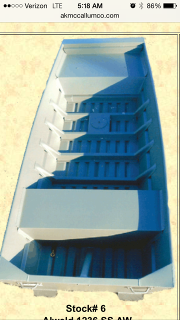

Alweld 1236 SS is a perfectly laid out boat for my needs. 0.080 all welded aluminum with a respectable sized front deck and open floor plan. Perfect for my solo fishing trips or bringing a buddy. I will use my SeaArk 1872 for big water adventures.
Well after waiting 3 months on my boat to be built, I finally got a call from A K Mccallum saying my boat was in. Here's a few pics of me bringing her home.
