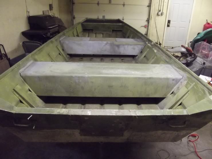

What I'd like to add to this thread are a few pics of my transom wood that I removed last night. Everytime I try to attach a file, or click Post-reply, I'm taken back to the login page, and then when I come back, my stuff is gone. Anyone know what's going on here?
Anyway, I am a 1st time poster (2nd time now I guess). I recently purchased a 1983 Landau 1670 (1648) FP. Anyone know what FP means?
I want to raise the transom up to 20" so I took it apart last night. I'm glad I did. The inner ply was pretty rotten. It fell apart after removal. I just used a cheap angle grinder to cut off the corner pieces and the rivets, which I then pounded out with a hammer and punch. I even cut off the top cap of the transom, planning to have someone weld on the additional 5 inches at a later date. I think I'm going to need taller knee braces as well...or figure out a way to extend the ones I have. I'd like to have new fabricated though. I think I'm going to give rivet bucking a try as well vs. ss nuts and bolts. I may find out that I have to rivet skill so who knows.
I've got a couple pics of this that I'll keep trying to post. I even made a Sketchup drawing of the current transom vs. the one I want.
I'm looking forward to working on this project and utilizing the good members of this site to help along the way. You guys already have actually.

I know this is old picture but I have the same boat and am considering replacing the transom board. When you did yours did you have to remove the "knee brace" to install the new board? If so how did you reattach the brace to the bottom of the hill. I know I'm going to have to trim the aluminum away as you did. Thanks in advance

The aluminum that you see in my picture is just covering the wood that is underneath it, there are bolts going through the aluminum from the outside of the boat through wood then through the aluminum you see on the inside
