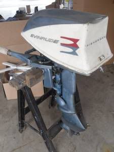

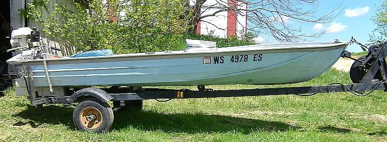

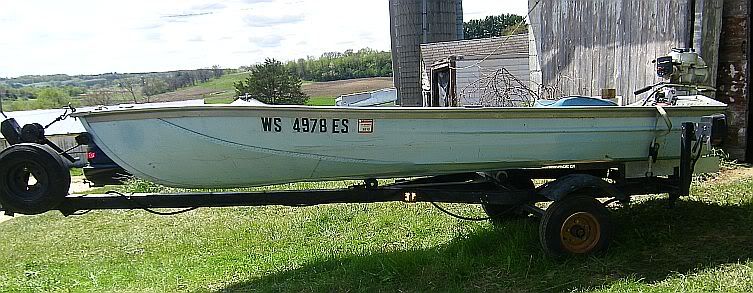

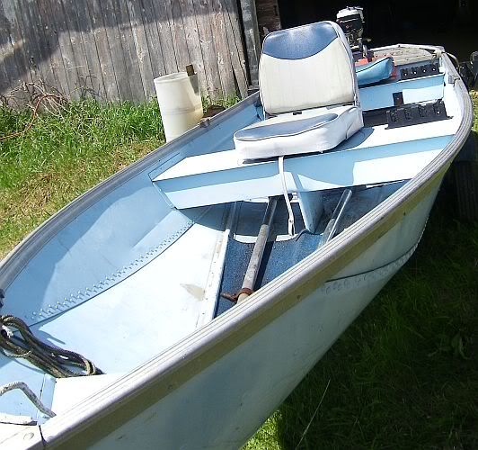

Some pictures of 1969 12ft Delhi, 1967 3.5 Clinton(Sears), no-name trailer.
Clinton 3.5
Motors for sale to be looked at (if the guy ever calls to verify the appointment.)
?7.5 Evinrude
?5hp Evinrude
With consideration of $ available, and my general physical condition, I'm leaning towards the 5hp. The old Clinton did just fine for a 45 year-old motor, but a little more ooomph, and more accessible repair opportunities,
make the Evinrudes more attractive to me. I'd rather bruise the budget rather than take chances on failed equipment out on a lake.
For what it is, the 12ft boat is just fine as is. Not a lot of things that CAN be done, much less need to be done. Tinboats kind of encourages folks to start modifying because others have done such neat and functional things to their watercraft.

That boat is almost just a wide square back canoe!
You're right, she doesn't really need anything, but a fishfinder might be nice, maybe more comfortable seats, and you could paint her metallic purple with orange glow in the dark flames on the sides... but that's about it.

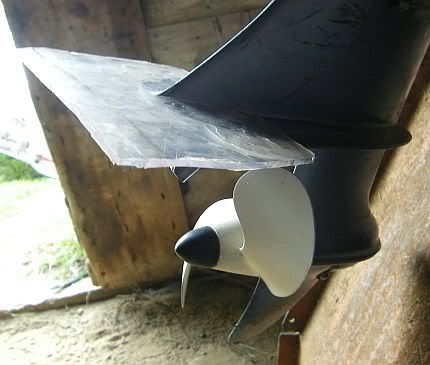

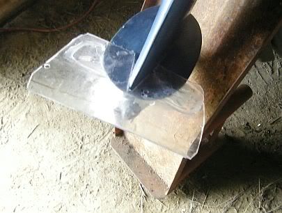

Never having been one to be deterred by common sense and accrued wisdom, I kept on chewing on ways to get the bow down of the 12ft boat. I put a 50lb sack of garden lime in the front, figuring that, at worst, the bow would be smacked by a wave and catapult the sack back to hit me in the forehead. :)
At best, it would balance the weight in the boat.
But I had a few days before I could get the boat out, having had a lapse of judgement and buying a 14ft Alumacraft F. I've just finished going over that poor derelict for the fifth time. I am really tired of scouring scum and oxidation, rotten carpet, dead bugs, and 15-year old lichen bits off the hull.
In the meantime, I was reading about tabs, and fins, and how they only work for bigger boats going up on plane, BUT keeping the bow down.
Why, I reasoned, wouldn't they have a similar effect on a smaller boat, even if it wasn't going to plane?
So...
took some lexan, got out my trusty Sportsman's Goop (like silicone), a couple of clamps and made a really crude fin for the ... er...defibrillator...uh...homogenizer...turmoil eliminator...damn...that fin above the propeller. I figured part of its function would be to redirect the water movement down and backwards and mitigate the push up by the prop. (Well, it made sense at the time.)
I reckoned it would be dislodged by the force of the water, but didn't want to drill and bolt anything to the motor. The Goop can be taken off with no damage to the metal. It stayed put during the test runs. :)
Had the boat out today. Again, it was windy, 10-15 mph, mid-40's, with a front pushing thunderstorms our way. I launched the boat, warmed it up, and accelerated with the wind at my back.
Whether it was the weight in front (probably), or the combination of the weight and lexan thingie, the little boat stayed on form, using its bow to cut water, rather than rising up above it. Going back into the wind, got some slap, but nothing at all like the previous times out. It bounced up a bit, but came right back down into the next wave.
Boat is really too small to play in water like that, and the hull design was never made for choppy or rough conditions, but this stuff happens. I'm much more comfortable with it now.
Here's the defibrillator:
(I know it is silly, but it was kind of fun to think I did more than add a sack of lime to the boat.)
If we EVER get some mild weather, I'll take the lime out and try just the fin. As it was, I was really cold by the time this outing was over.

Well done. I love an experimenter....especially one who gets results from his work.
When comparing Fins (defibrillator!!!) to Tabs....I suggest you review the tape here
https://www.nauticusinc.com/system_overview.htm
Might show that they BOTH work... and they work in different ways. Rich

While I still like "defibrillator," I admit I was pretty tired yesterday and just could not remember the correct term.
This from one web post: "The purpose of the plate (call it what you want - doesn't really matter) is to make it more difficult for air to get to the prop from the surface of the water."
In doing a web search, found this in a 2006 posting on a site, where some pretty experienced guys were bickering over the correct term:
"I realize the fact the the plate has nothing to do with cavitation, and its proper term should be ventilation plate.
I posted the yamaha site to show that they call it a cavitation plate. Its not just a "new boater" that confuses the term, apparently its the people that build the damn engine as well."
So, although "defibrillator" still has my affection, the name of the thingie is (perhaps) "cavitation" plate, "anti-cavitation" plate, "ventilation" plate, or something else.
No where did I find that they were to be used by small motors on small boats.
