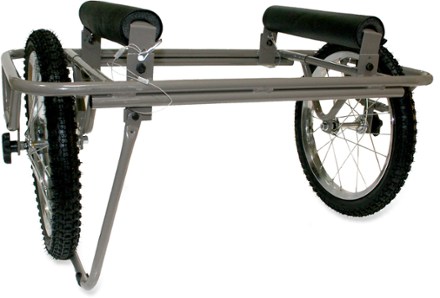

Alternatively, look at making or buying something like the attached boat transporter. It is strapped onto the bottom and puts no strain on the transom. They are used to move kayaks all of the time.
A number of YouTube videos are available. I'd search under kayak transporter or something similar to that. I have one under my kayak right now. Some PVC, a couple of wheels ( I bought an old golf bag trolley and stole the wheels from it) and you can make one in an hour. richg99
https://www.rei.com/product/815324/padd ... oCs7Lw_wcB
Thanks for the suggestion. To be completely honest within a few hours of buying the boat I drilled 4 holes in the transom to fit these wheel. Now I have I think I'd prefer to use them and make them work for me also I have had people comment how practical which they are. Now thanks to your advice I have decided to bin the steal as the electro erosion would be a concern. Instead I'll find a 4mm ally plate and cut to fit snugly on the inside of the transom apply some marine sealant and use the holes Iv already made. Plus may need to add a few more rivets to sure thing up but as few as possible.
