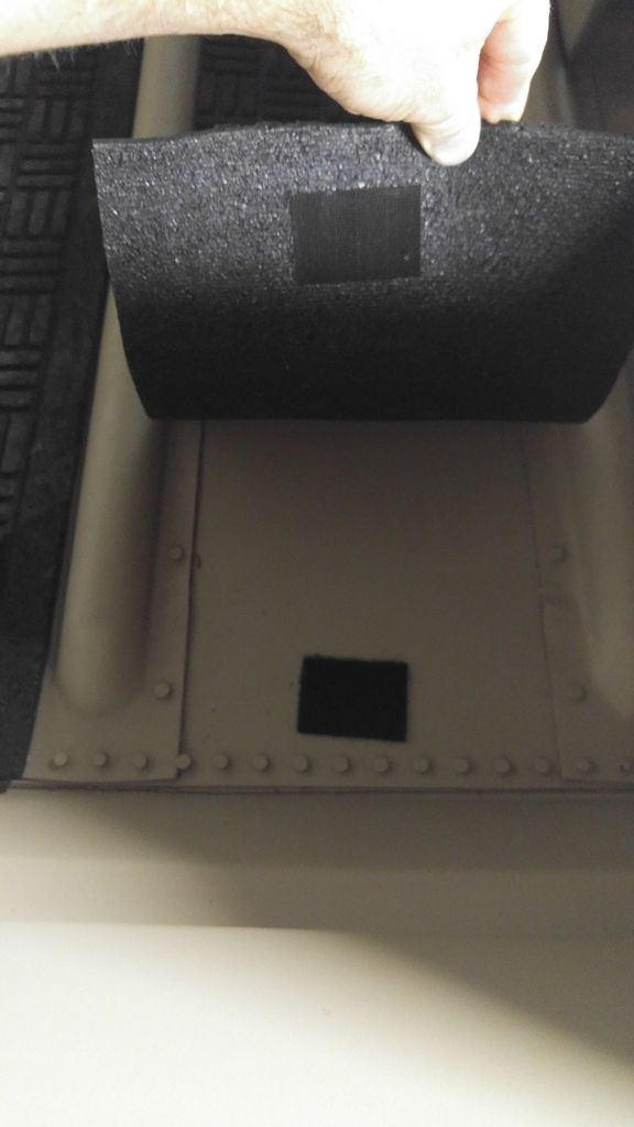

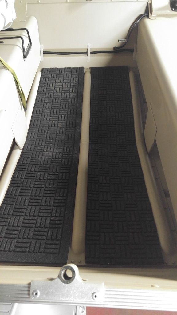

if you go the rubber mat route here is a little tip if you want a quick easy way to mount and remove the mat. get some industrial strength velcro that is self adhesive and cut 1"-2" strips for the corners of the mat, one half of the velcro stick to the boat the other half you super glue to the back side of the mat (the self adhesive don't stick to rubber) now the mat can't blow out or slide when you step on it and it's quick and easy to remove, if you ever decide you no longer want the mat you just peel the strips off the boat.I have the mats in the floor of my boat held in this way and it's great.
