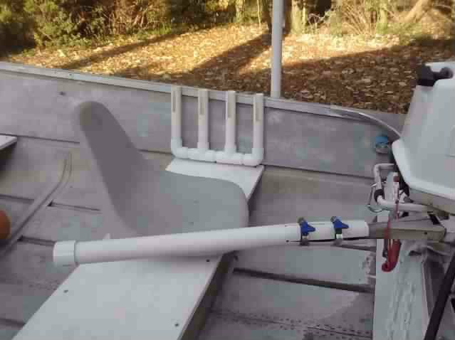

Very cool! Here's a little tiller extension I made for my '66 20 hp Johnson. It's just a piece of 1 1/4" thin-walled PVC with a few slits in one end (be sure to drill a small hole at the end of each slice to prevent splitting), and a couple of pipe clamps. It works great! While I can remove it in about 10 seconds if need be, I just leave it on all the time. It makes steering super easy, allows me move forward in the boat to get on plane more quickly and allows me to stand up on my back bench at low speeds to see where I'm going. Best of all it only cost about $2!

kfa4303 wrote:Very cool! Here's a little tiller extension I made for my '66 20 hp Johnson. It's just a piece of 1 1/4" thin-walled PVC with a few slits in one end (be sure to drill a small hole at the end of each slice to prevent splitting), and a couple of pipe clamps. It works great! While I can remove it in about 10 seconds if need be, I just leave it on all the time. It makes steering super easy, allows me move forward in the boat to get on plane more quickly and allows me to stand up on my back bench at low speeds to see where I'm going. Best of all it only cost about $2!
Welcome to the Forums :)
Tiller extension topics come up fairly often around here, and I will admit--this is a pretty good example of how to make one. With that being said, the moderators frown upon digging up old 'archival' threads and posting new stuff on them. It just helps keep the forums from getting overly cluttered with repetitive information. But on the plus side, nice job on using the search feature!!
