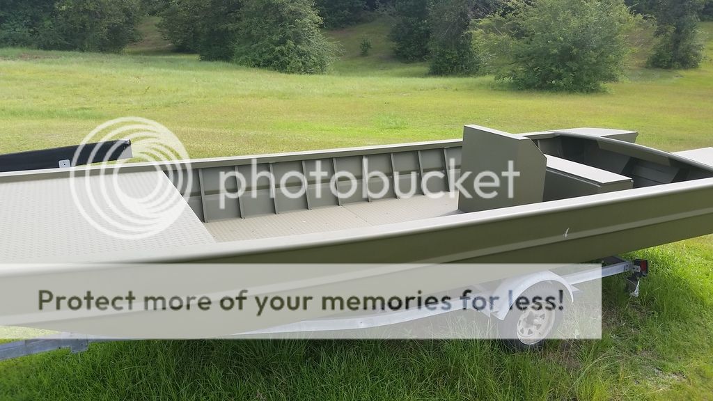

I think I'm going to go with that 2072 as well. I went to chat with my local guy yesterday and he had this one sitting out in the yard. I was thinking I didn't want a 20 foot boat but it's not really as big as i was thinking. If It's not this one he'll build me one just like it. All 1/8 with heavier wide gunnels, which I really like. They're wide enough to sit on.
