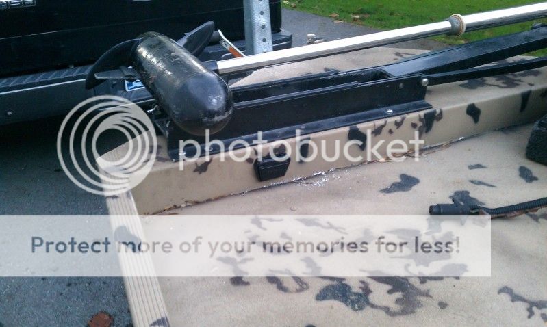

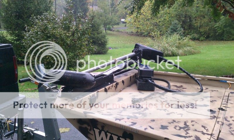

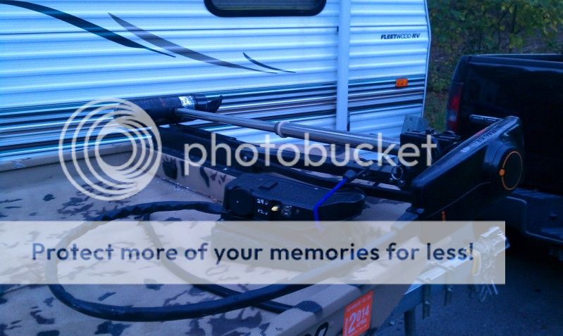

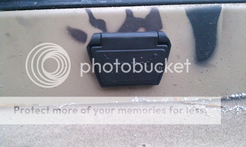

Got a few pics of my trolling motor setup. I played around with several different ways to mount it and ending up mouting it length wise on the bow from starboard to port. Mounting it along either the port or starboard sides would interfere with the captain and controls to much. Other than being a bit of a hazard when boarding/unboarding the boat from the bow, it works good where it's at. We installed it with rivit nuts so it can easily be removed when needed. Also installed an Attwood TM plug. You should be able to see in one of the pictures on the foot pedal there is a switch for 12V or 24V. We rewired this an installed a new switch that when on 12V it runs when you have your foot on the "throttle". When it's on 24V the "throttle" acts as an on/off switch so you can run it constant without having to keep your foot on the pedal.
Attwood plug. TM is routed to the port side battery. Only other thing hooked up to this battery is the 12V accessory plug located in the rear bench which is used primarily for a spotlight while running to hunting spots early in the morning.

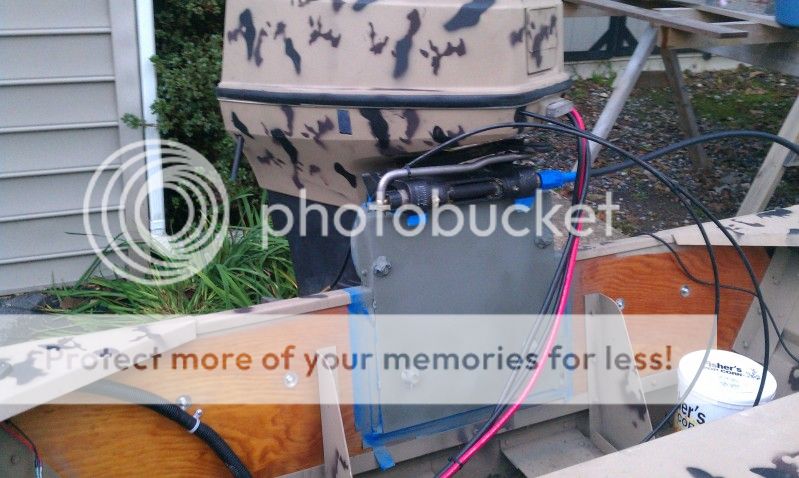

Got my transom riser primed last night. Planning on painting it to match the boat this evening. Can't have all that shiny aluminum showing while duck hunting. Also should make it easier to see any cracks or voids in the riser, if it were ever to get any.

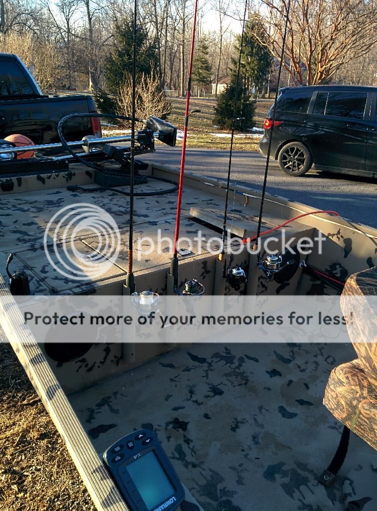

Got a few things done to the boat over the weekend to get her ready for fishing now that the weather FINALLY seems like it's going to break. Once we got the motor issues figured out this past fall, we haven't had any issues with the boat and motor all winter. I'd guess we had her out over a dozen times over the winter waterfowl hunting. Everything seems setup just right for the way we use the boat. Glad I was patient in deciding exactly how I wanted everything setup. Hopefully everything continues to run well. Havne't had her out in almost 2 months due to the crappy weather we've been having. Missed the final month or so of waterfowl season due to either snow, ice or dangerous river conditions.

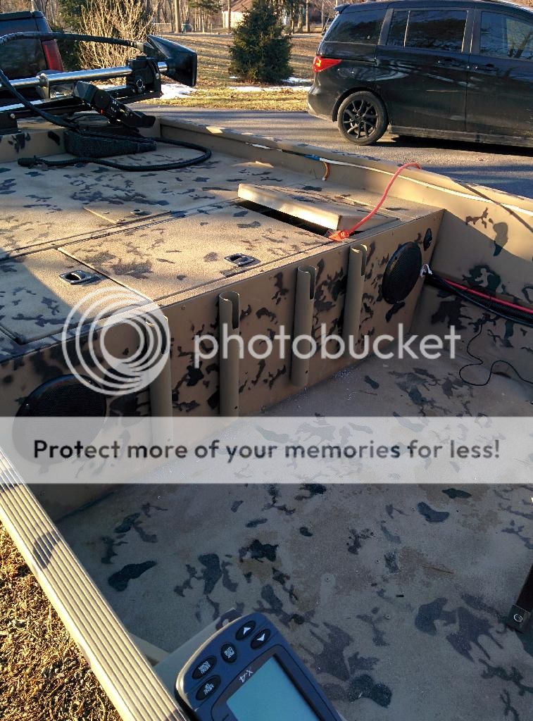

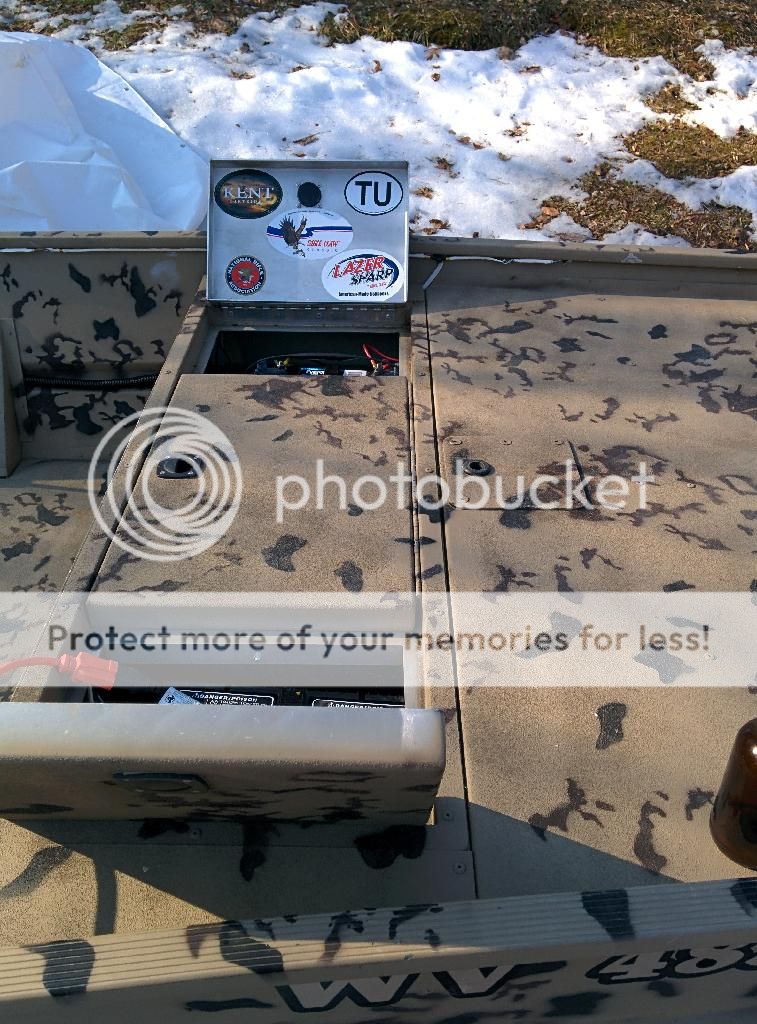

Got an extra seat and 2 13" pedestal for the rear bench and front deck. Front deck is WAY to flimsly though. Need to figure out a way to reinforce the stock aluminum deck and or seat base before it gets used. Any suggestions?
Here is the front deck base. It sits on the factory deck which is rather thin aluminum. It flexes ALOT from bow to stern with the seat and pedestal installed. Any suggestions on how I can reinforce before I rip up my bow deck?

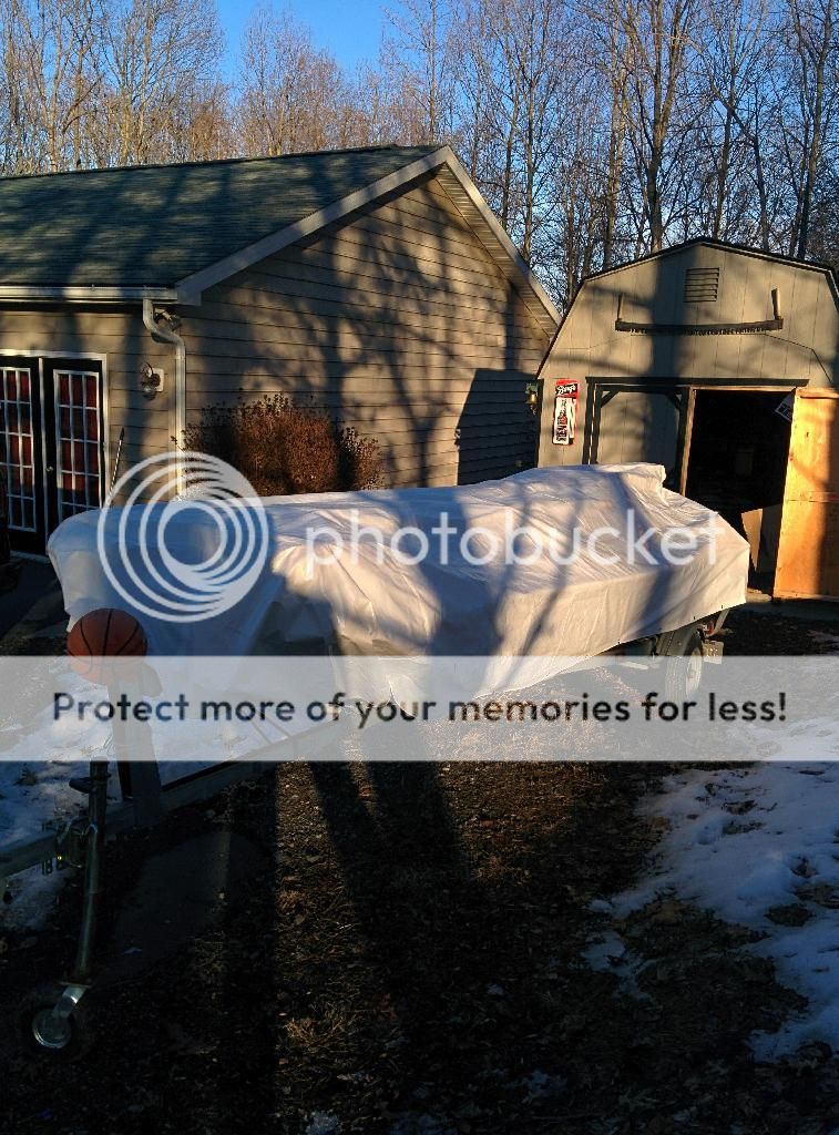

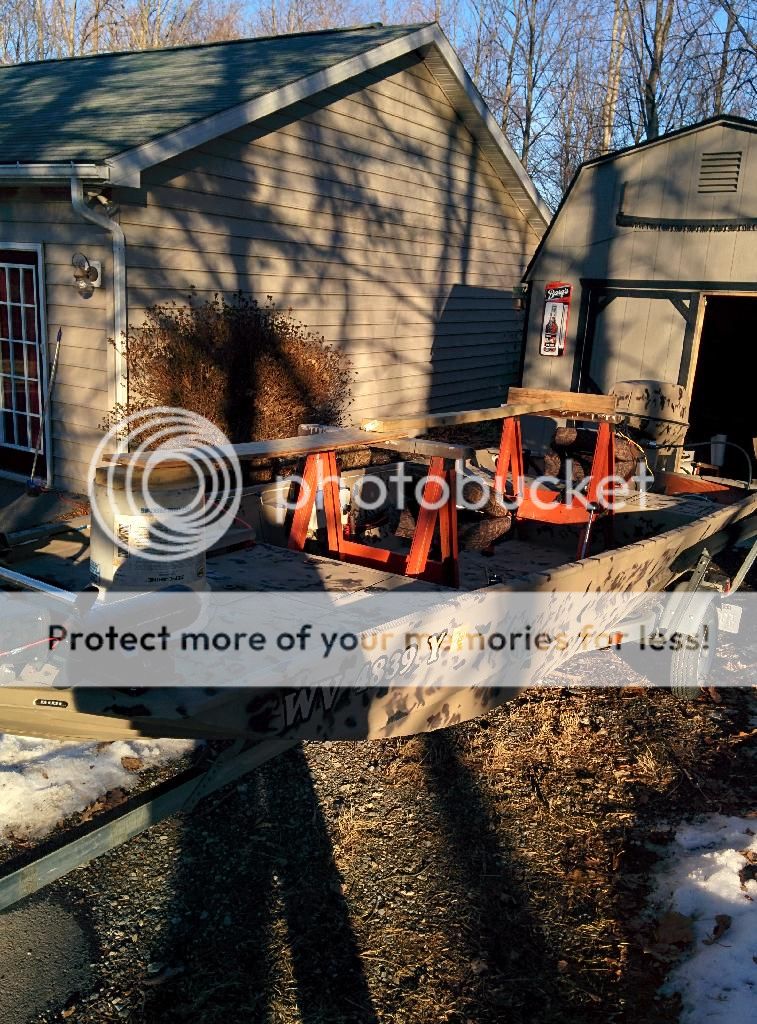

Ordered a heavy duty tarp of Ebay last fall to use as a cover. It's OK for $30, but I've already had to tape up a few tears with some gorrilla tape. Worked pretty good with all the snow and ice we had over the winter, so I guess I really can't complain. Here is how I support my cover. 2 small sawhorses, a long 2x4, bucket and bungee straps.
Cover on

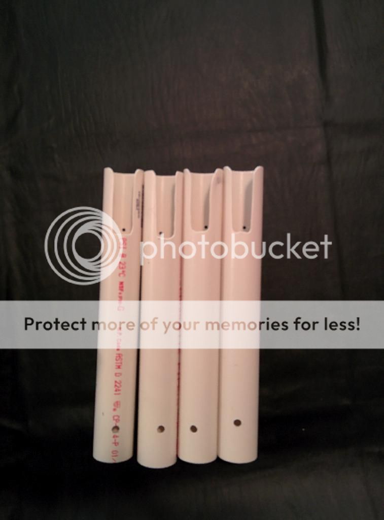

Made some rodholders out of PVC. I have a grip type additive on my floor and deck paint. I was afraid it would tear up my rods and reels so decided some rodholers were in order. Used 1-1/4" PVC for about $4.50 for 10'. Only used 4' of it though. Probably use the rest to make a rodholder stand for my rec room. I thought they turned out nicely.
I have 4 rodholders coming from https://www.metalrodholders.com/. Once I get those installed the only thing left to do is fabricate and install a stern deck. Then I think I can finally call her finished.

Looking good Terp! Just in time as weather seems to be breaking finally. Whats with the basket ball? Is that a cover/protector? Reminds me of the old folks with tennis balls on their walkers or hitch ball covers.
Posts: 2019
Tracker Sportsman 16' - Some Finishing Touches
Post by BigTerp » 10 Mar 2014, 12:04
panFried » 30 minutes ago wrote:Looking good Terp! Just in time as weather seems to be breaking finally. Whats with the basket ball? Is that a cover/protector? Reminds me of the old folks with tennis balls on their walkers or hitch ball covers.
Thanks man!!
Yes, the basketball is to protect the cover. Since it's not custom fit, depending on how the cover falls when I put it on, it sometimes is over the wench bracket which could easily tear right through my cover.
