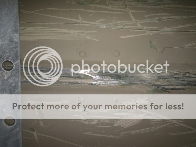

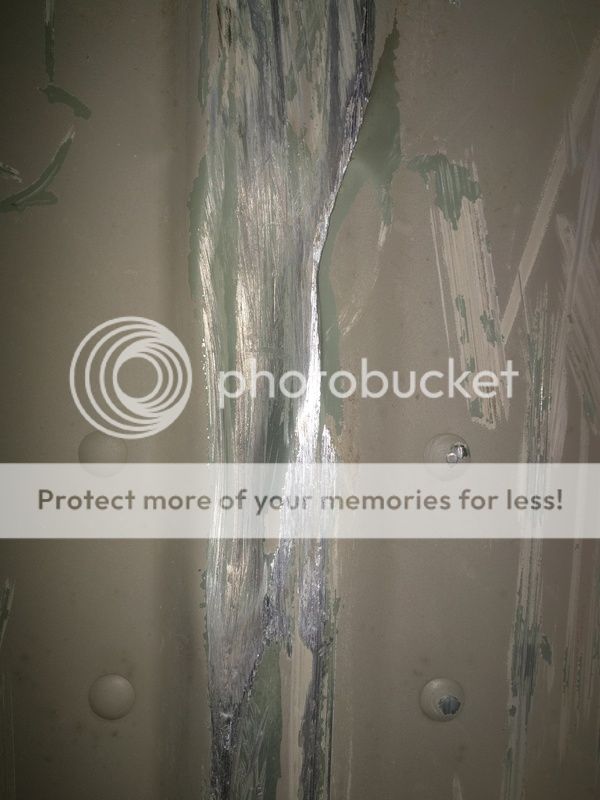

I have a dent or two in my Tracker 1648 hull bottom that I'm pretty sure is effecting my performance. Loosing about 5 mph at WOT. Previously with my '94 Johnson 50/35 I was getting upper 20's and now I'm in the low 20's. Only other thing I can think of is water logged foam, but I replaced the foam in late 2013 with the blue stuff from Lowes. So I doubt that is the issue. Only way for me to find out is to pull my floor, which is doable but would involve a lot of work. I want to clean up the dents, particular a bigger one that is in the center chine about 16-18" from the stern. I'm guessing that is the main culprit for my performance drop. Thinking of ways to get it smoothed back out without trying to beat the dent itself out, which I think will only cause more issues. I'm thinking of using JB water weld to pack the dent and then sand it all down as smooth as possible once it cures. Not sure how well it would hold up though. Have also considered filling the dent by throwing down some welds and then grinding it smooth. But my hull is pretty thin, probably .080 or less and welding it is a major PITA!! Have also looked at the aluminum flux rods to fill in the dents. What do you guys think? Would any of those options help with my issue?

Not sure if that's the case or not. Would think I would be getting some cavitation if so, which I do not experience. I think the bottom of my hull just isn't smooth like it used to be and is causing excessive drag while on plane. I'll get some pictures when I have the chance of my hull bottom. The dent in the center chine is fairly significant. There are a few others here and there that may or may not be causing some drag as well. I can't imagine it's water logged foam because with 3 guys and hunting gear I was getting better top end then I am now without all that weight. Nothing else has changed with my setup either. Motor runs great and the impeller is properly shimmed and in good shape along with my liner. My boat does run better with a passenger in the back and I fished by myself 90% of the time last year. So I may be over reacting a bit, but it definitely doesn't have the performance it use to.

Depend on how bad the dent is, might put a straight edge on the bottom of the boat to see how much hook you have. When eyeballing the bottom of a boat you normally don't notice hook as much as a big dent but they both hurt top end especially on a 40/28. Post some pics.
Only other thin I could think of you might check you motor height, I've seen the bolts back of just enough to let the motor slip down and that will slow you down.

Motor height is good. It's on a static transom riser and can't go down any further. There might be a little hook right at the transom, but it's only in one spot and maybe 10" worth of the transom length. The rest seems nice and straight.
Here are some pictures of the dent. It's on the middle chine about 14-16" in front of the transom and jet foot. The dent itself is about 6" long and the width of the chine. Best pictures I could get for now.

Sounds like you need a thicker hull. I've had some riveted boats and I would never go back just to thin especially for a jet boat you plan on running shallow where some hits are inevitable. You could try and push the dents out somewhat, I imagine the hook is what doing the most depending on bad it is.

Best I could think of would be to try and carefully push the dents out. That thin aluminum it can be hard to do that without creating a crack at a crease.
