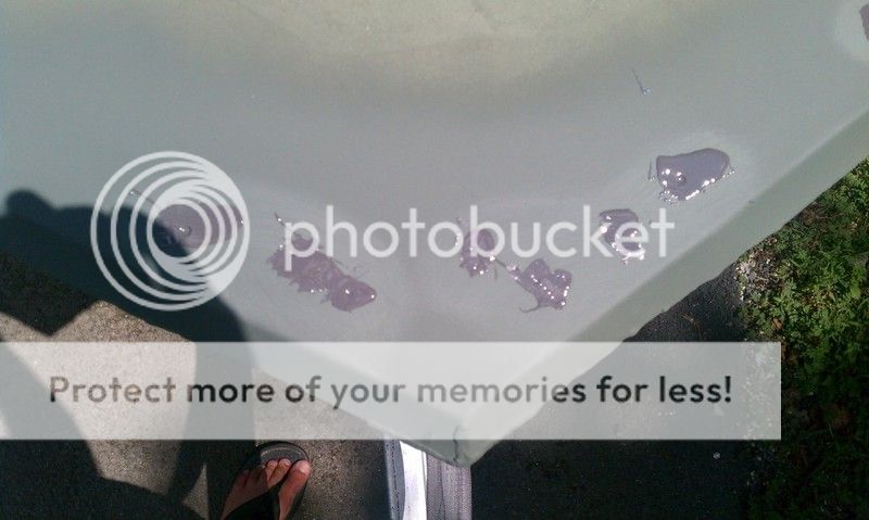

JB Weld works good for cosmetic holes above the water line. The PO of my boat had a piece of angle iron screwed to the bow deck to mount a trolling motor. I cleaned up the holes well and applied JB Weld. Then sanded smooth primed and painted. Cannot even see where the holes were and they've held up for nearly 4 years now. Did the same to some holes in my rear bench that the PO had drilled in it for whatever reason and they turned out just as good.

here is a technique that I use - - - - it works with any epoxy or JB Weld liquid epoxy.
if you can not get to the underside of the seat to block the flow of epoxy,
cut very small pieces of masking tape just big enough to cover the hole
after it has been dented with the ball peen hammer.
then proceed with the patch process of your choice.
just filling the holes with Bondo or epoxy paste will not hold for long.

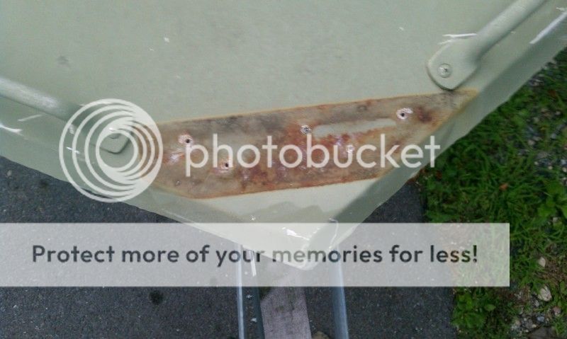

So here is a pic of some of the holes.
The diameter is about 1/4" so I suspect that they are a bit too big to just epoxy (JB Weld) shut, especially since there is no access from underneath.
So the surgery I'm thinking about doing is: 1) center punch the holes so they cave inward (downward, gravity-wise) 2) cut aluminum can circles to fit in the very bottom of hole, leaving space on top for 3) Marine Tex or JBweld which can then be 4) Sanded smooth and painted.
Thoughts? Thanks to all for comments.

Just wondering if there was some sort of support under those holes that has been removed?

Nope. I think it was some sort of a base plate for a seat. Through the holes you can see the Styrofoam flotation.
