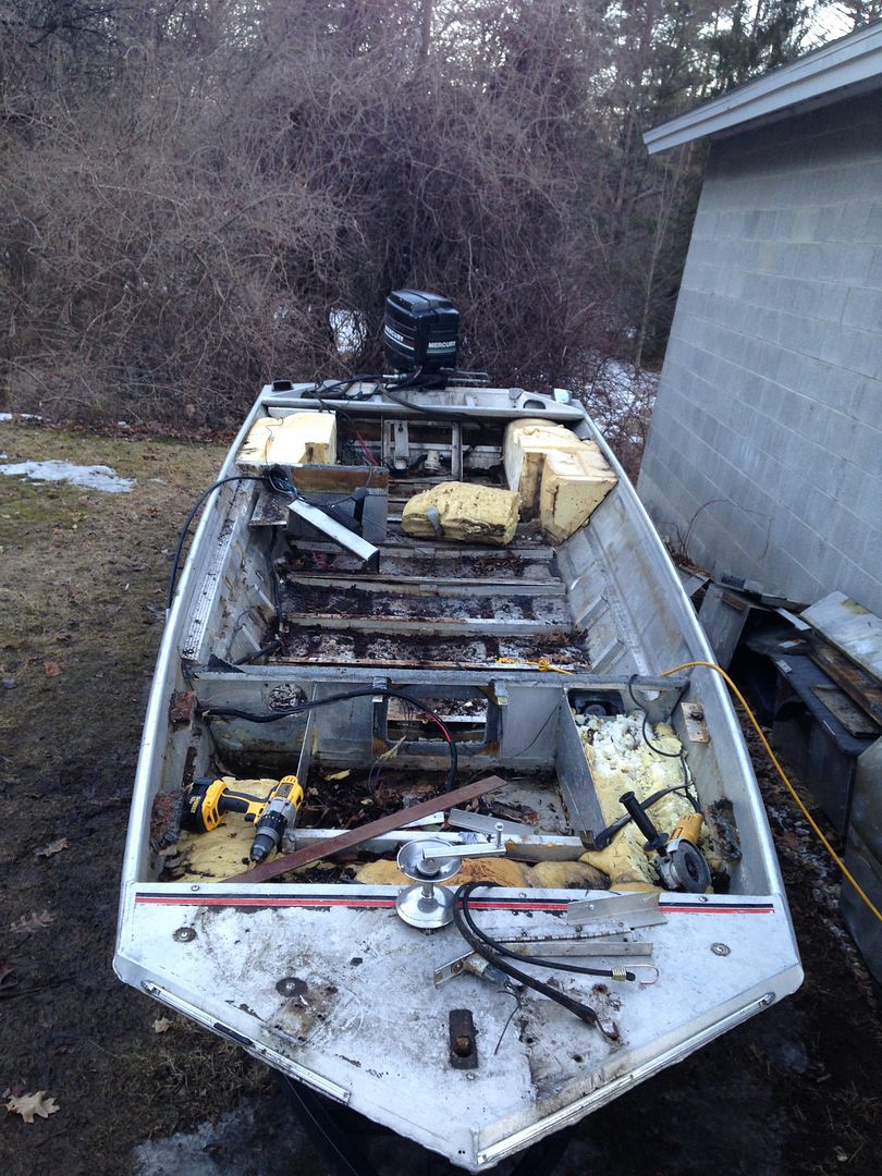

Little more progress tonight. All stripped now

Pulled the motor off and the last of the riveted metal and cleaned it up a lot with the shop vac.
Next up I need to cut the transom and replace the wood
