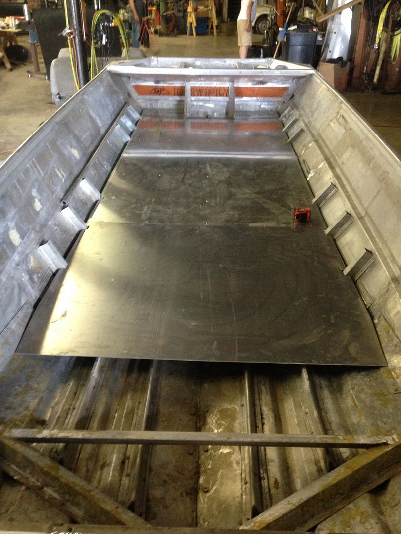

Got the front floor section cut today, it's hard to see here but the rear section is already riveted in. 11.5' of floor in minus a foot and a half the rear bench will take up.
Angle to reinforce the front floor
In front of the floor I'll make square sections from angle to hold the gas tank and 2 batteries. 1 battery for the starter and accessories and 1 deep cycle battery for the front trolling motor and ice blaster. The front deck will overhang these.
Still need to get some 3 or 4" aluminum strips and have them welded down the sides so nothing falls under the floor. Also need to get the rear bench and front deck fabricated and welded.
